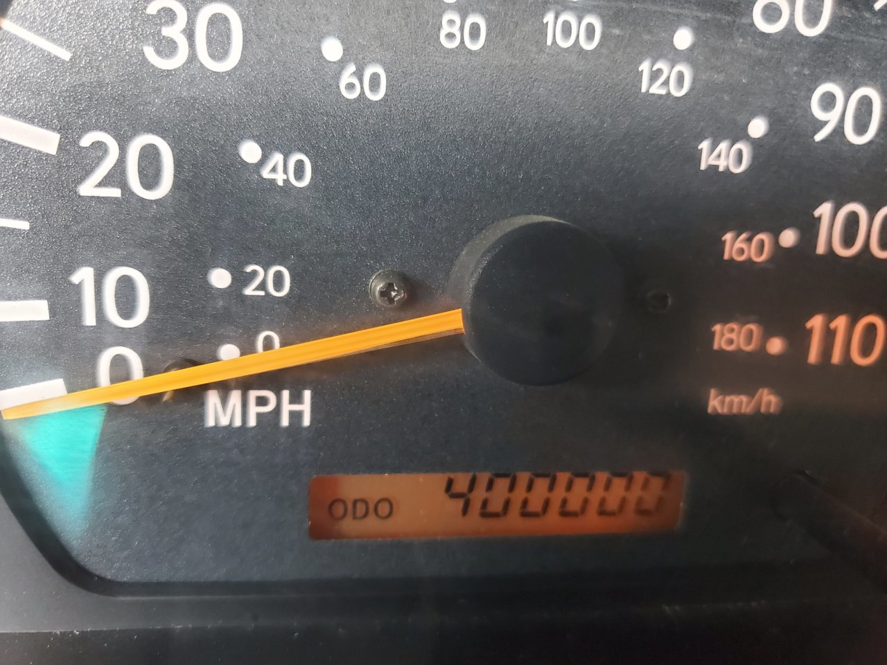

a new chapter begins... the road to 400k

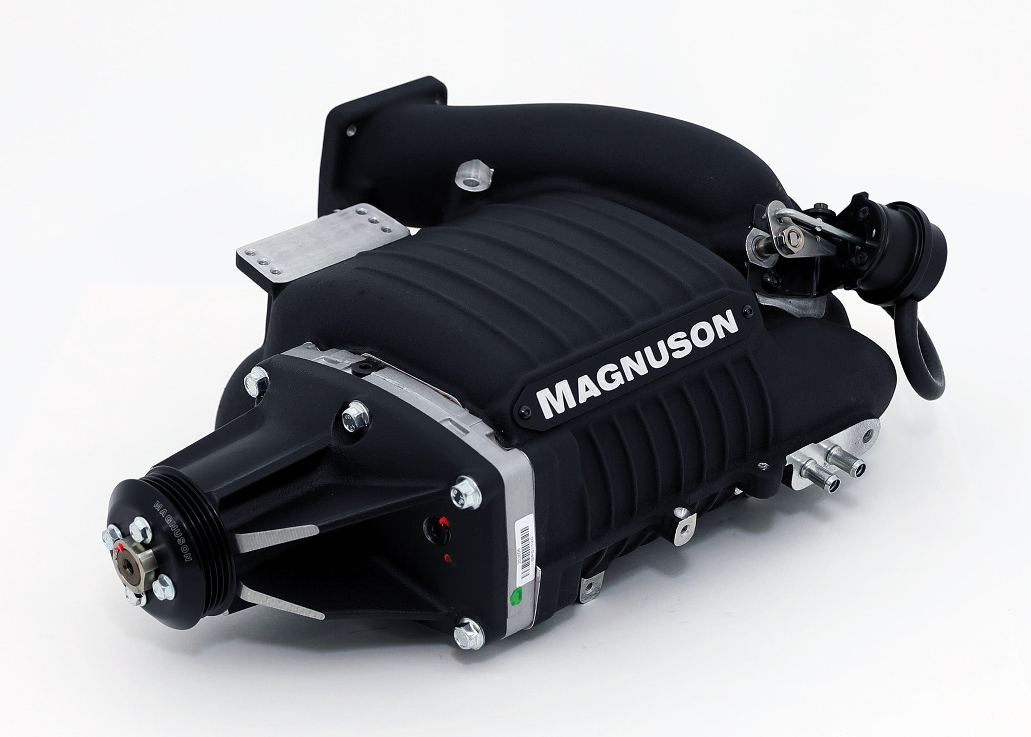

perhaps i need this installed for the mountain wheels up the steeper grades
Turbo is better imo.
i just read that turbo is not allowed in some states per inspection
superCharger is 50-state compliant
Never heard that one. Many cars, especially today, and just about all large trucks are turbo equipped. It would mean the new tacoma would be illegal to be sold, or operated in those states.
Linked to quote From my taco peer in Denver with 750k supercharged miles on his rig
