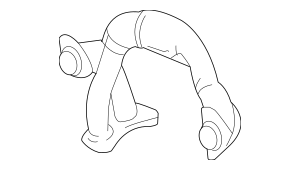

I doubt it, Its likely some sort of heat shield.Could this pingy pesky rattle be this possibly?
It is in the general area of which the sound is being observed at the firewall

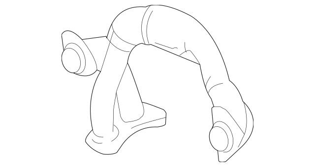

17106-62020 - Crossover Pipe 1995-2001 Toyota | Ourisman Toyota Parts
Save Money On Your Crossover Pipe (1710662020) For Your 1995-2001 Toyota When You Shop With Ourisman Toyota Parts!toyotaparts.ourismantoyotaofrichmond.com
379$ MSRP
That crossover pipe was rubber hose on those early v6 engines till toyota got wise, and made them out of metal. When it ruptured, your engine lost all its oil, and seized up.
