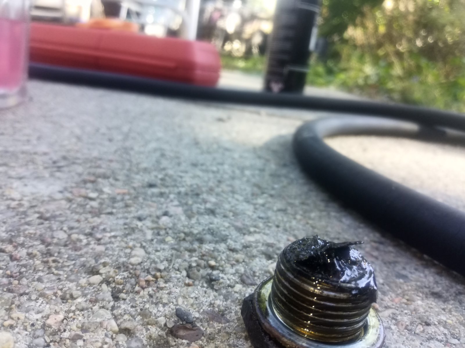

Thats not the greatest to suck out the fluid, you want to clean the drain plug of any metal...plugs are usually magnetic, plus those suction hoses don't get all the nasty stuff way at the bottom that collects.

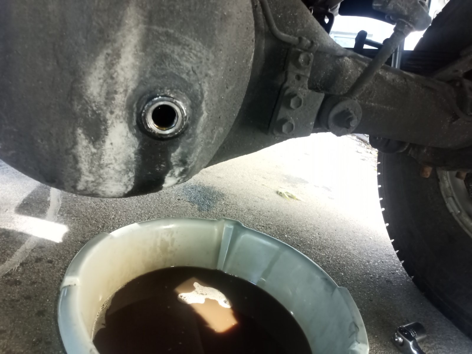

Went at the diff drain plug with the 24" breaker
I barely coughed and it broke free with near zero efforts

Torque both plugs to about 39ftlbs

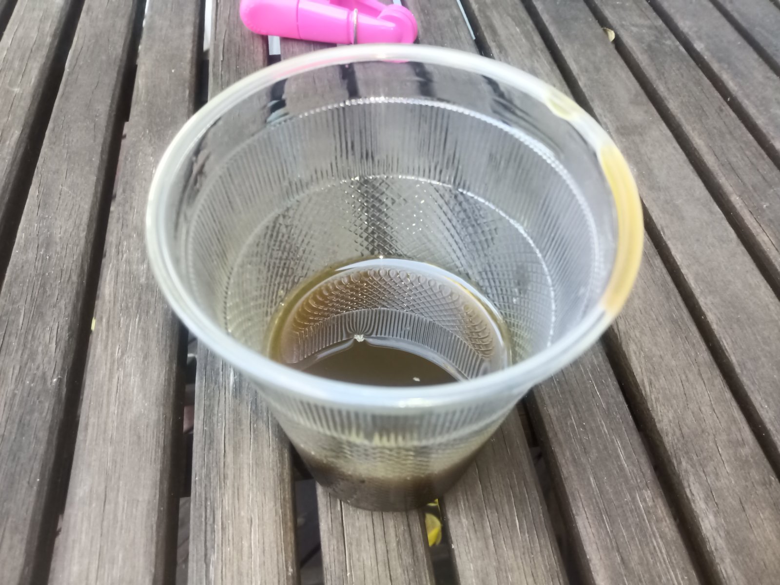

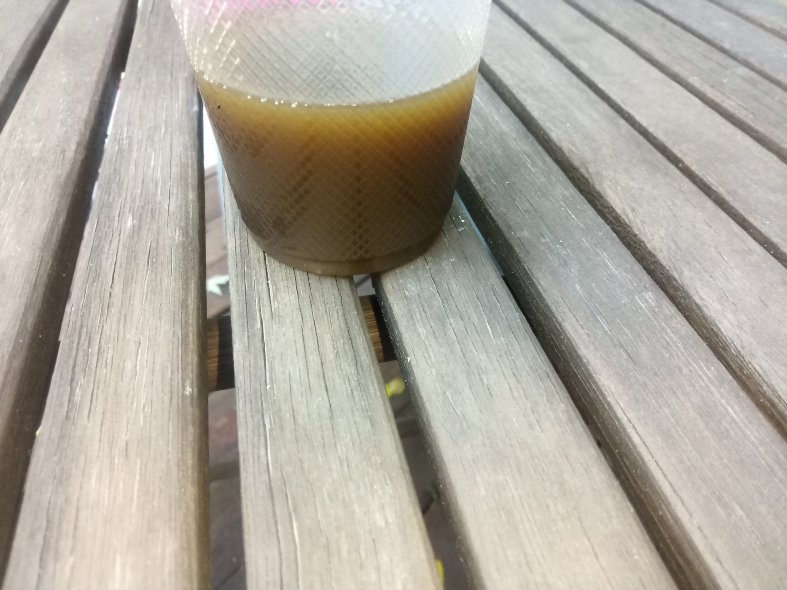

Rear differential usually takes about 3-4 qts. The front one around a qt. or so.
Your old fluid doesn't look all that bad. I've seen worse in 30k miles.
