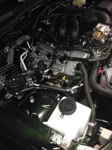

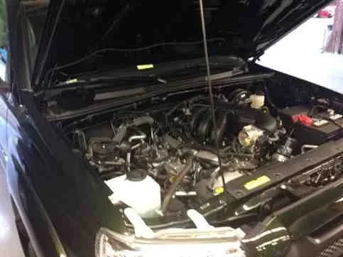

Here's is with stock removed and about to start install process. I have finished the install forgot a final picture though. Sound is better when wide open. Fit is good. Little more play in it than I would like. More complex than I thought for install. Not hard but didn't expect to relocate smog pump. ImageUploadedByTaco Forum1380158177.934256.jpgImageUploadedByTaco Forum1380158201.998102.jpg

I installed this setup yesterday on a 2013 V6. Three things they could improve on. First the intake on the air box came up about 1/2 inch short of the fire wall which will allow hot air from the engine compartment in (yes I had the seal in place. Second, relocated smog pump is now resting on engine component, will have to watch for wearing a hole in rubber boot on smog pump, and third the instructions want you to re-use stud off old intake to secure the cowling. This stud is pressed or glued in and I would have to damage intake to remove.
Now the good. It looks great in place, motor has deeper growl and butt dyno tells me I've got more pull in the higher RPM range.

Pretty much agree with all of this. Didn't like the smog pump relocation at all. The stud I thought could have been done better. Mine was removed
