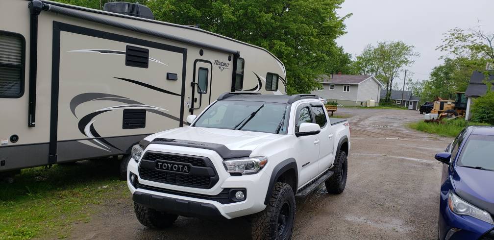

I bought one. For the price, I’d thought I’d take a chance. Enough people on here and other sites had bought one with out any issues so I felt confident. It took about two weeks to arrive. When I got it the box looked like it had been stomped on. “No pressure Thanks” was scribbled on the box. Once opened, I saw that three tabs were broken off. I called the company back and they made it right but I still wanted to try the grill. It snapped on even with the three tabs missing and it fits tight. Some of the cuts were right so I had to Drimmel those out. I’m pleased with it so far. It looks great and I’m the only one, besides you all, that knows there are broken tabs.
