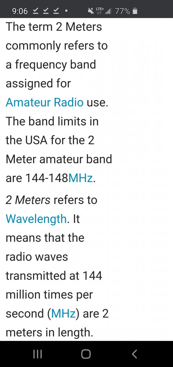

Its just the wave length of the signal is about 2 meters roughly.
Operates from about 144 to 148 mhz frequency i think...but please don't quote me on that.

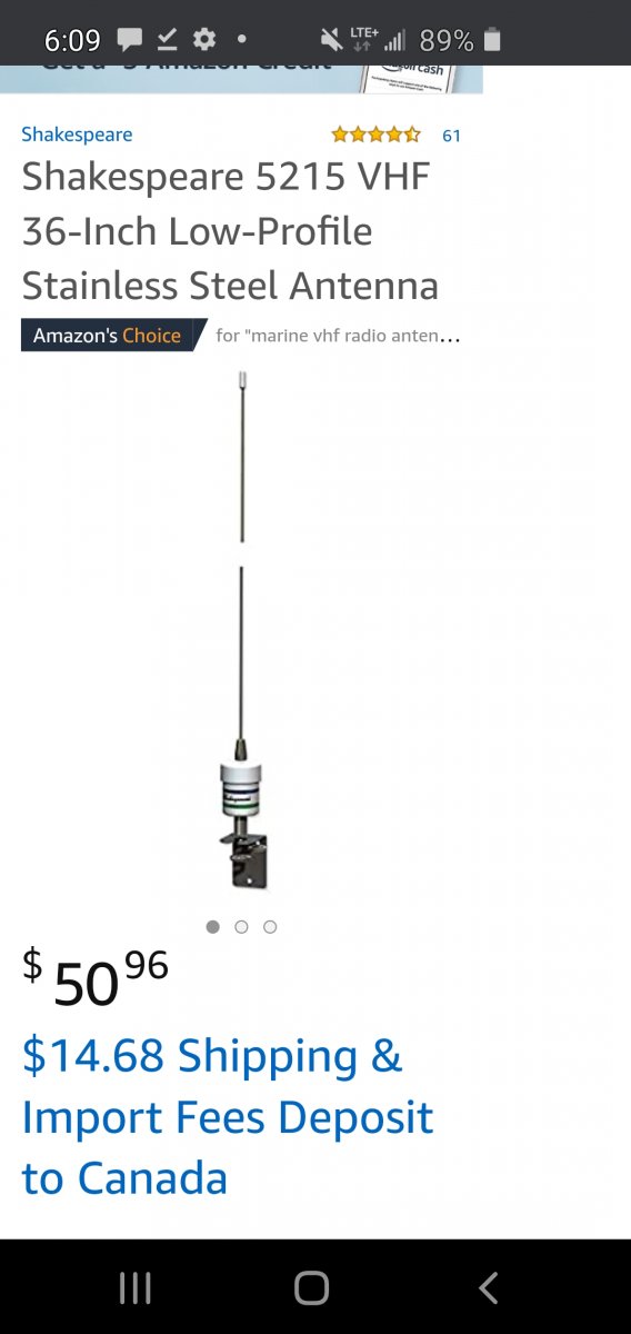

I personally use a Shakespeare 5215 about 3 feet long in total, but front fender mounted, its not a lot higher than the cab roof, and it is flexible so running into tree branches and the garage door doesn't hurt it.
Don't buy a cheap $20 antenna, spend $70 on a good one. Get a radio with good wattage to, that will increase your transmission power.

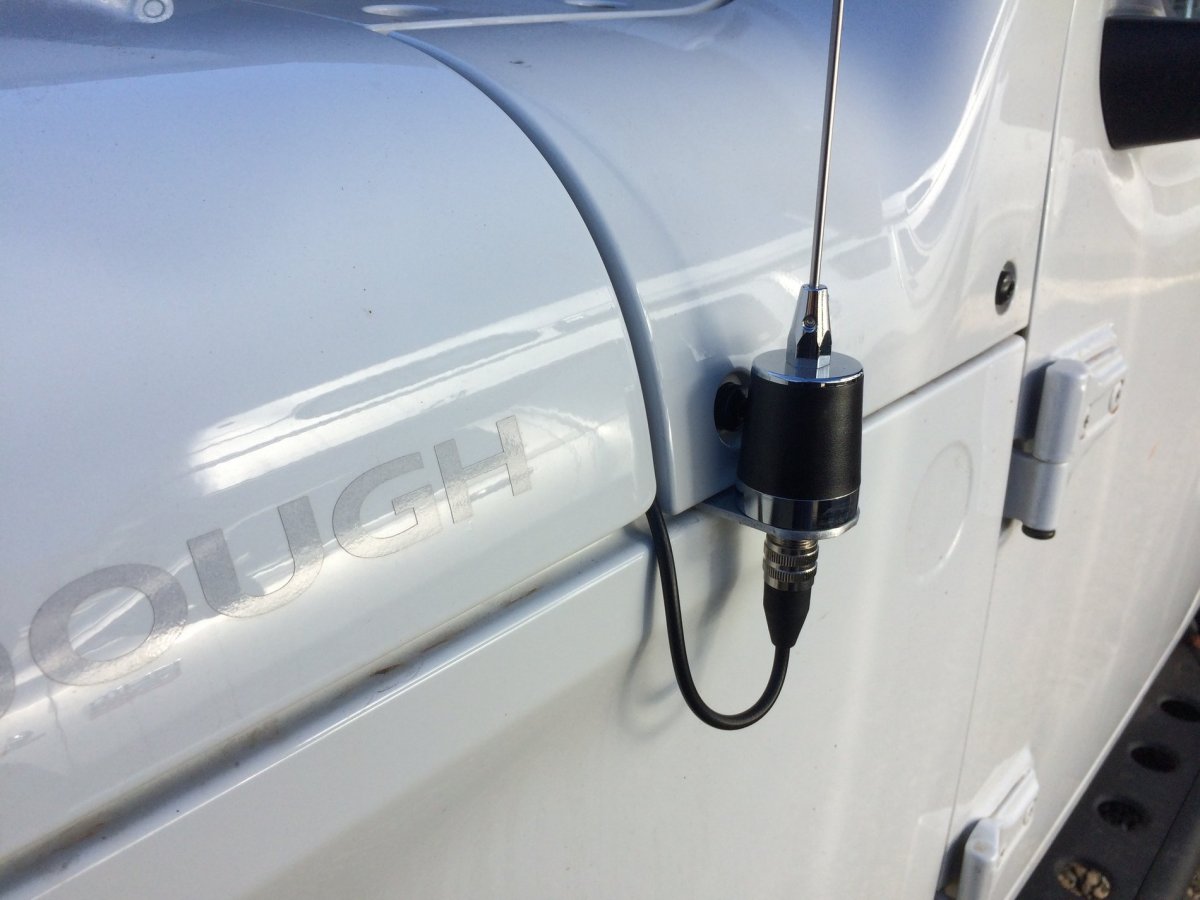

Don't over think about the mounting, do similar to this person, fender mounted is fine, and really easy to wire, just sneak the cable through an existing grommet in the firewall if you want to, or buy a grommet to, and drill a hole. Fuse the power wire to the radio, and try mounting it where you don't smash your knees into it every time you jump into the truck. Some idiots mount radios right where they are perfect to hit every time I get in...probably doesn't help any that I'm tall.
