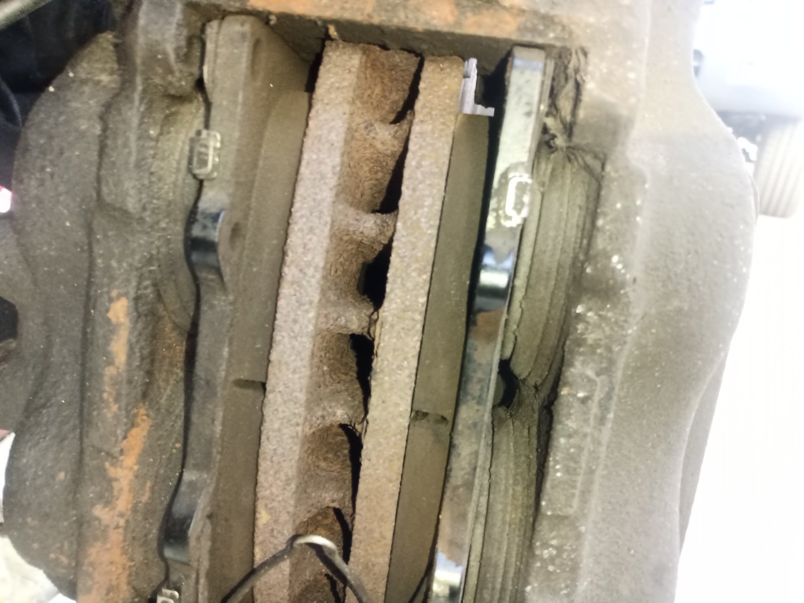

yota dealer that did the brakes more than 2 years ago forgot to put the right top caliper slide pin in
likely the cause of the clunking from that time ago?
That will cause noises when the brakes are applied. Some aftermarket pads will do the same, as their metal backing is not cast as precise as toyota ones
