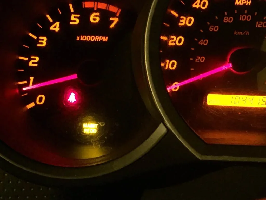

Does this necessarily mean I need to change my oil, low oil, or something that has nothing to do with oil??
Turn key off, then press and hold the odometer deal down while you Turn key to run (or whatever is 1 click from starting)...
U should see a series of 0's..... hold until they all go away.
This is exactly what happened:
I did my oil change at about 99,000 miles.
Then had to make the drive to NC, by the time I realized it I was at about 102,200 miles
So I just decided to do a whole new oil change. I'm at about 104,200 miles
I didn't reset main. Light when I changed my oil at 102,200 miles because it was never on. Did I have to reset everything by disconnecting battery? Also could it be that my MAF is dirty?
U went 5k miles..... reset the maint light with the procedure i posted.
No need to disconnect anything.
Dirty maf wouldnt throw a maint light.
So you're saying the ECU is reading is following the first oil change and not my second one?
the ecu doesnt read ANY oil change and the light needs to be reset manually with the procedure above. Pulling the negative battery terminal will just screw up ur radio stations, make it shift different if its an auto, and may or may not cancel the light.
Here comes the drop:
The maintenance reminder is strictly for oil changes and it flashes near 5K miles and comes on at 5K miles. To reset it; key off, select the odometer readout on the black gauge trucks and trip A on the white face trucks, push and hold then turn the key too on until the "0"s disappear.
Gotcha. So once I reset it, do I go as scheduled with the Milage from my last oil change, or should I count 5k starting after this reset?
