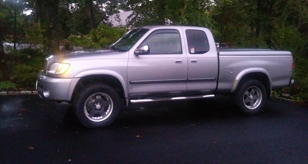

Yes i still see mine around town almost weekly .it had 285/60/18 on 8.5 moda rims .should have kept them cuz they fit the tacom no rubbing before i lifted it . 20171014_181541.jpg
