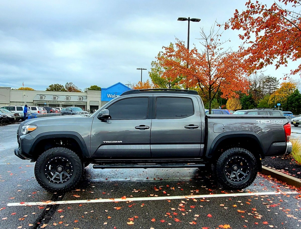

Awesome truck!Before I lifted my 2017 TRD DCSBOR I read through alot of internet posts and gathered an idea of what I was looking to do and what problems I might run into. I lucked out and got what I wanted with no problems.
16" KMC XD135 WHEELS
Falken Wildpeaks 265×75×R16
Bilstein 6112's up front clips set at 6 driver, 5 passenger
Bilstein 5160's in back
Headstrong 3 leaf progressive AAL w/Overload left in
Nothing else regarding lift added.
Alignment is perfect. Stock UCA's. No rub. And I take it through some gnarly **** and then back on the road where it handles much better than when stock.View attachment 27710View attachment 27711View attachment 27712
