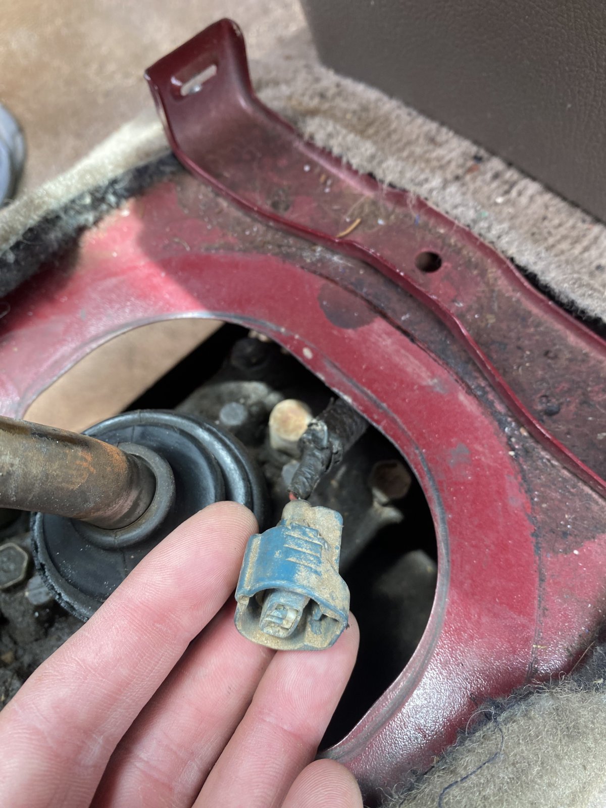

noticeable increase in fuel consumption, losing 50 tacoMiles per tank of tacoJuice... what is going on?
could that open connector be the one that is supposed to be plugged into the front 02 sensor??
the downstream 02 sensor is a gray plug so IDK!?!
if that sensor is unplugged would the truck even run? run rough? trigger a CEL?
wot is the deal here..
Your asking me? its your truck. I never owned a gen1 tacoma, let alone did any real work on one.
I'd try stretching out this cable to see what it reach's that has a similar plug with a male end. If nothing comes up..it can't be anything to worry about. Sorry if I come across gruff, but I hate spoon feeding guys that don't put in the effort to exhaust these issue's first.

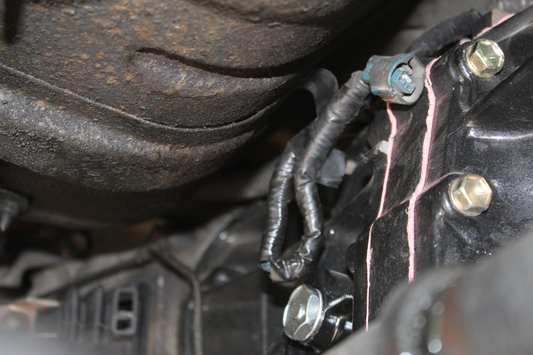

it looks as though it is all bound up with black electrical tape?
no need to feel sorry about it at all, tacoJoel
you cannot spoon feed nobody if you have no clues + experience in the matters
no knowledge to pass it on...
the knowledge i personally acquire i do and will pass it on in return for zero coz that is how i roll with the flavour
i have to go through one of those timmy the toolman videos on the gen3 T4R clutch replacement AGAIN
see if there are some clues inside there about this open plug
