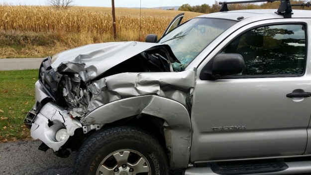

Castrol synthetic edge 5/30. Either bosch or mobil 1 filter. Every12,000 miles. And the truck had 228,000 on it till it was totaled last month. No engine ping was a rock. 2007 v6 6 speed. Double cab.
