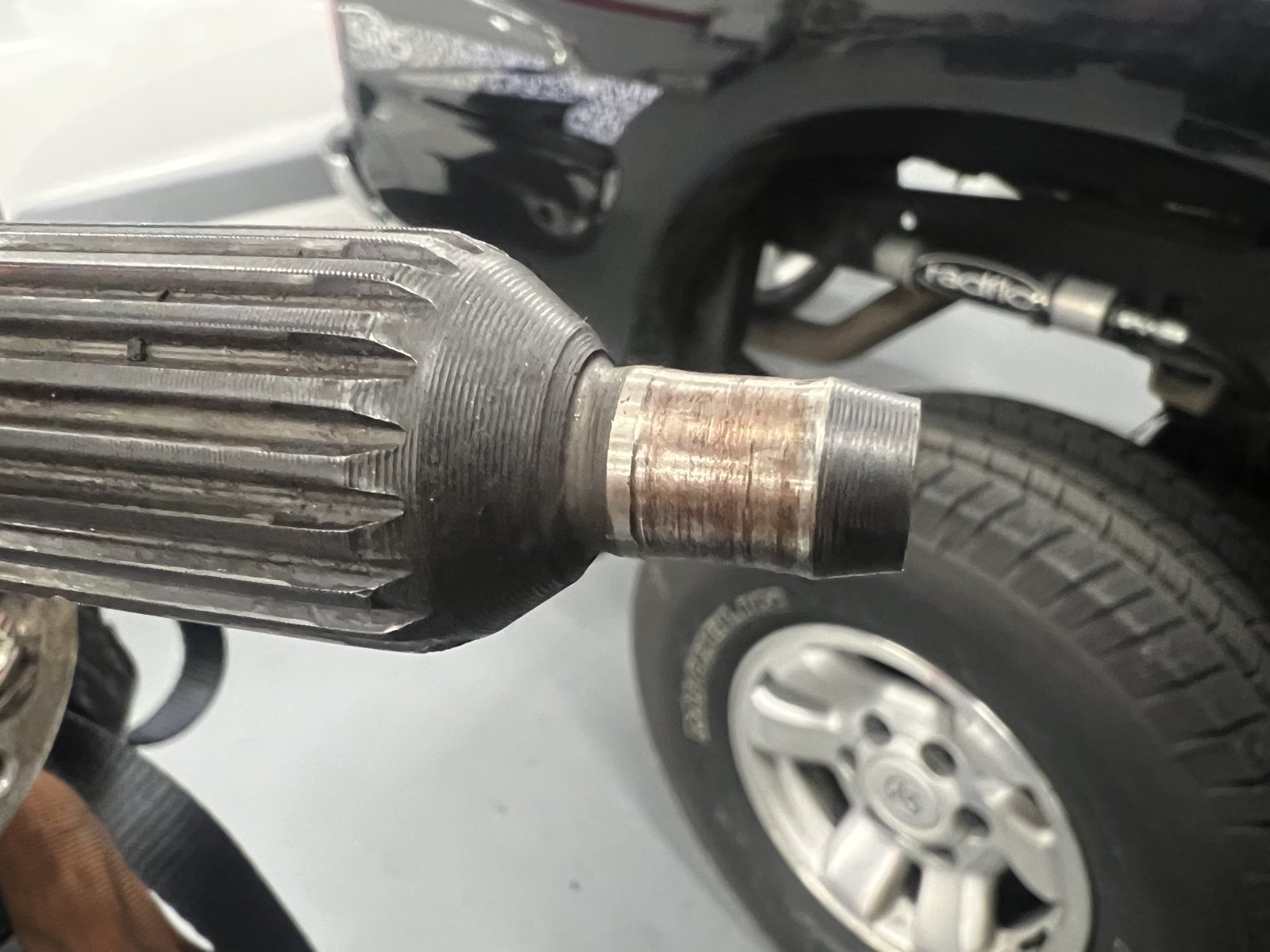

) come across a dimension for the R155F input shaft end, specifically where it mates the pilot bearing? Even the ID of the pilot bearing would work. Can't find anything in the FSM and my google fu is failing me.
Mine has some obvious, but not terrible wear (@160k) and I'm concerned that it may need to be replaced or sleeved so it mates with the pilot bearing correctly. Should have noticed it earlier, but of course I didn't till after the clutch/flywheel was replaced.

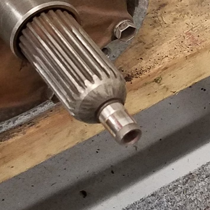

Grab a new pilot bearing and try slipping it onto the input shaft . Does the pilot bearing wobble when you move it back and fourth ? If yes , the input shaft needs replacement . The only time the pilot bearing is in use is when you have your clutch pedal down . The spinning clutch disc is pulled away from the flywheeel and this is when the pilot bearing begins supporting the spinning clutch disc . You will hear noise when the clutch is pushed down .
what my rigs input shaft looks like at 341k with factory pilot bearing scarring
You need to replace the shaft. The bearing's view that shaft is extremely undersized and worn.
The bearing depends on the press fit between the inner race and shaft.
If you do not replace the shaft, then expect the bearing to fail very very very early.
