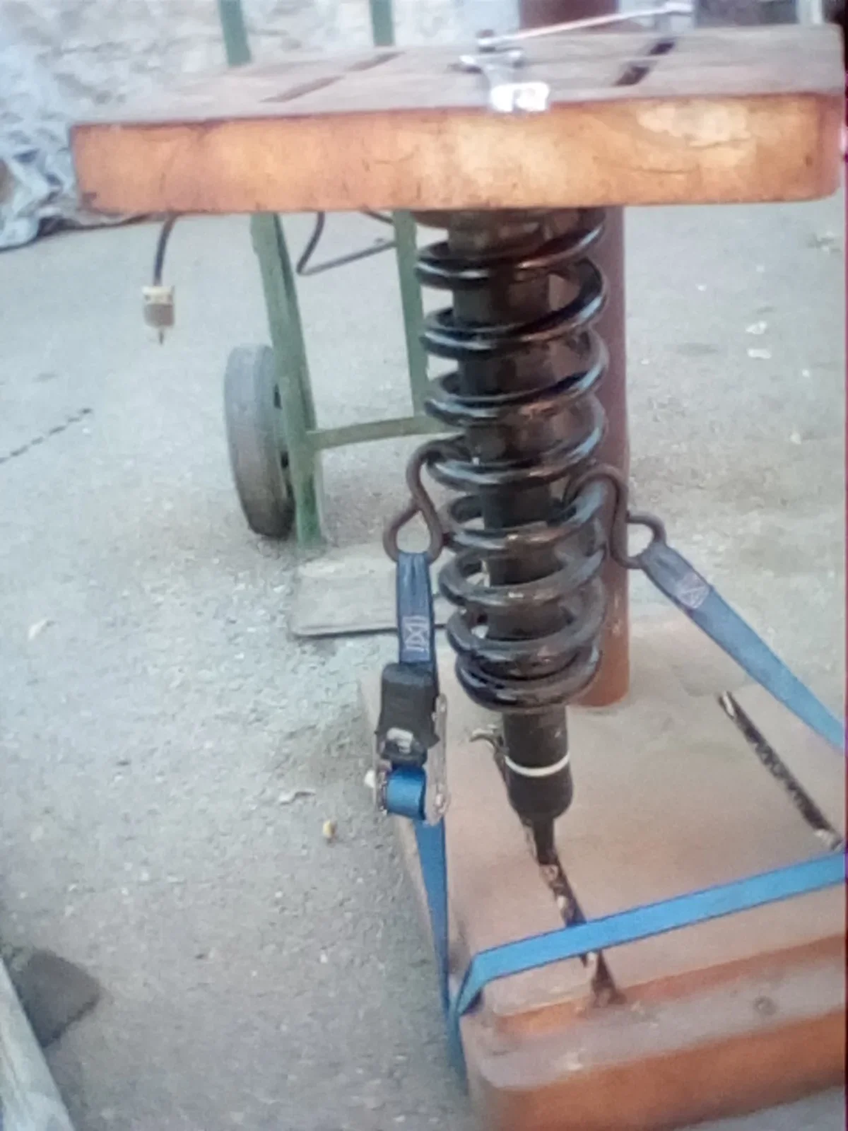

Well I got curious today about swapping out some 2nd gen. coils with the stock coils on my 1st gen. , more to settle a debate about this question that always comes up at some point if you wrench at all, a couple of donor front struts off a 2015 sport given to me have been staring me in the face for about a month now, just begging to be disfigured & today was the day...
First thing i had to do was compress them with no compressor....

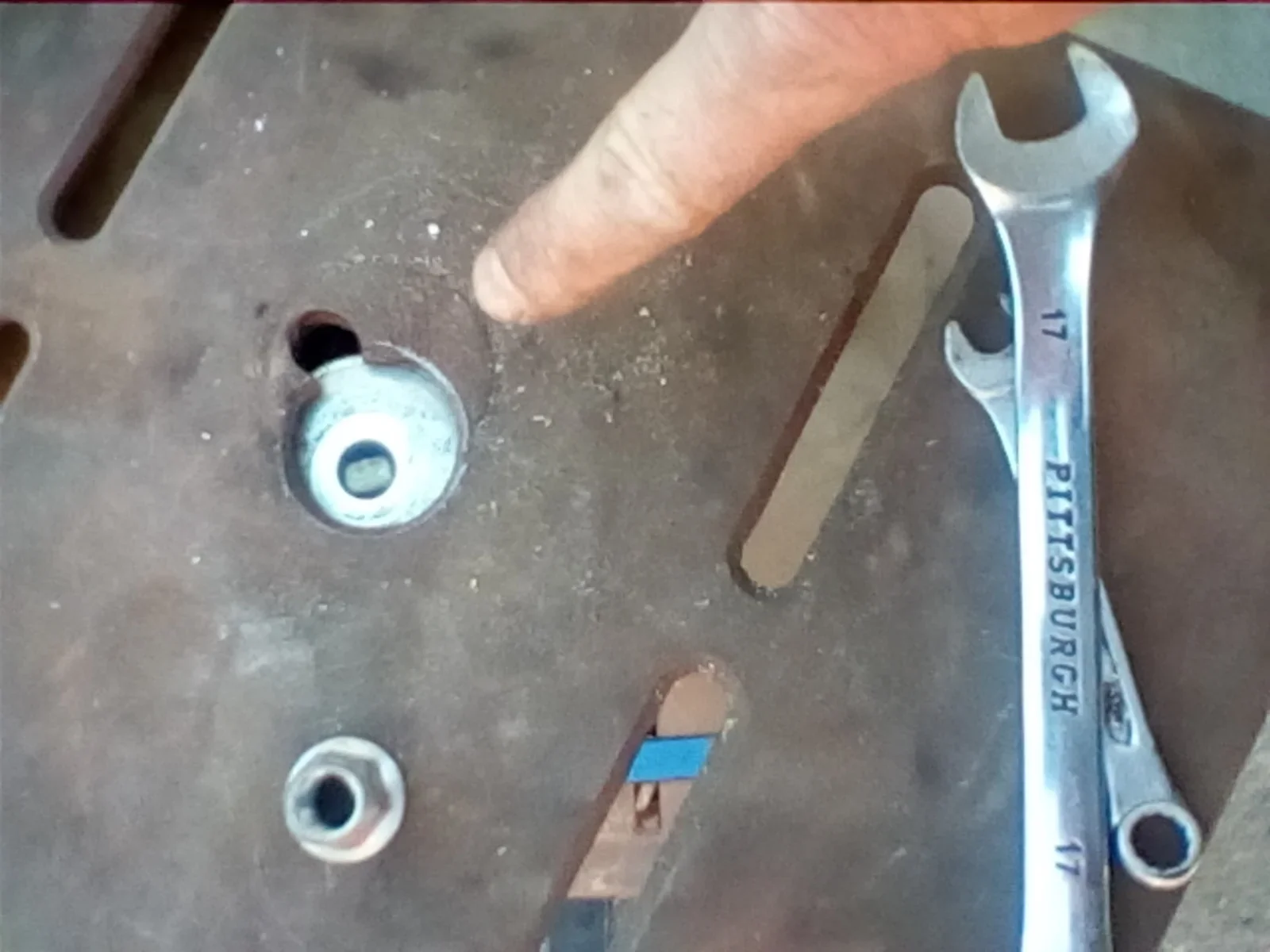

This was done with an old very heavy ass drill press by raising/lowering table in small increments (for safety)
I would turn a few threads & release the pre load pressure by slowly loosening the table allowing the tension of spring to nudge the table up slightly, re tighten & loosen a few more threads, repeat until compression was gone ...
I DO NOT ENDORSE THIS METHOD !!
Compressing coils springs is no joke & one little **** up can & has maimed &/or killed before, so if not sure, just pay someone to do it, be safe...
(although out of 100 or so I've done, only a couple sketchy moments with the all thread bullshit compressors
That’s creative man. I figured you’d have a compressor as many as you’ve done.

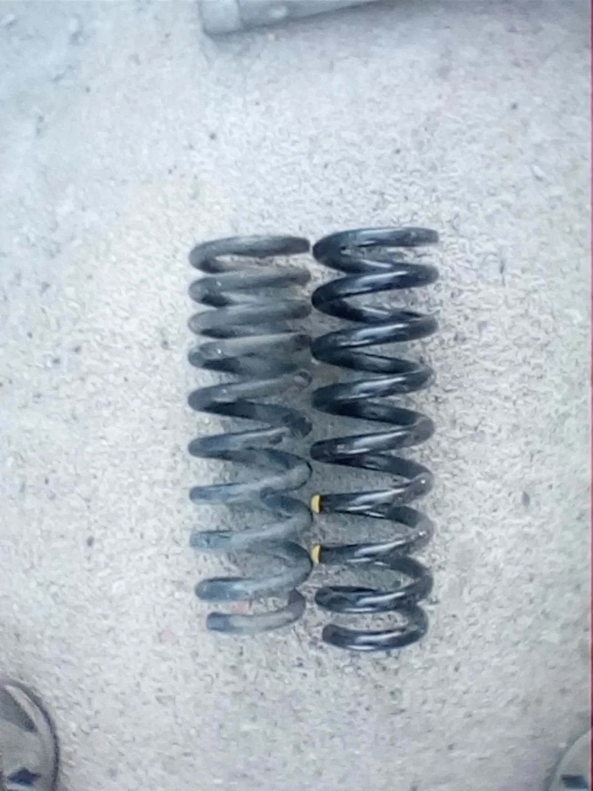

Basic differences on first look is 2nd gen coil is about an inch longer than the progressive 1st gen coil...
But spring fits properly on perch & dia. is same
(2nd gen on right)

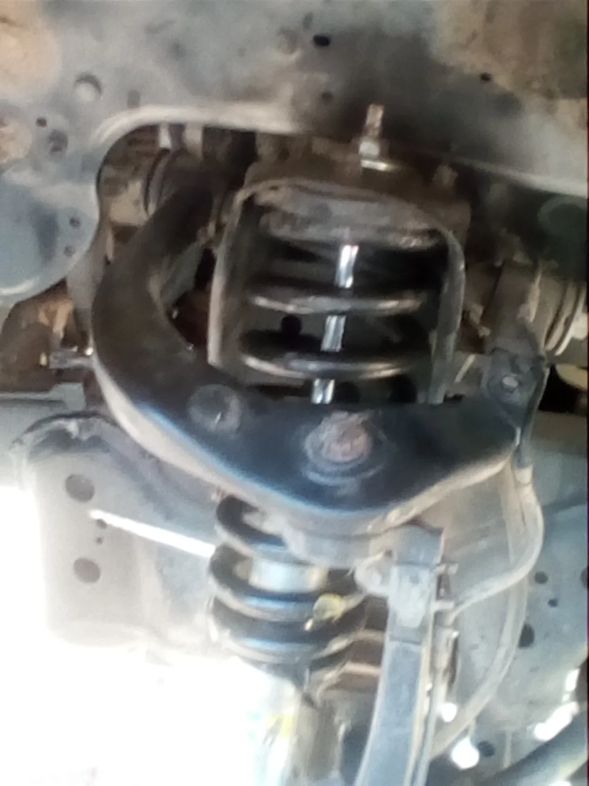

I don't use a compressor anymore if I can avoid it, I just get front off ground jack stand the frame, off the tire, let it droop , get a floor jack under the LCA (with shock still attached at bottom) remove lower ball joint, take off center nut on strut, lower jack, de compressed, done... ;)
EDIT: I mark the positions of the LCA adjusters front & back before I loosen, saves a lot of $$$ on alignment...
EDIT AGAIN:
Almost pointless to mark because right now out of range... anytime you lift or change geometry is a better term, you'll have to re align...
(2nd gen on right)

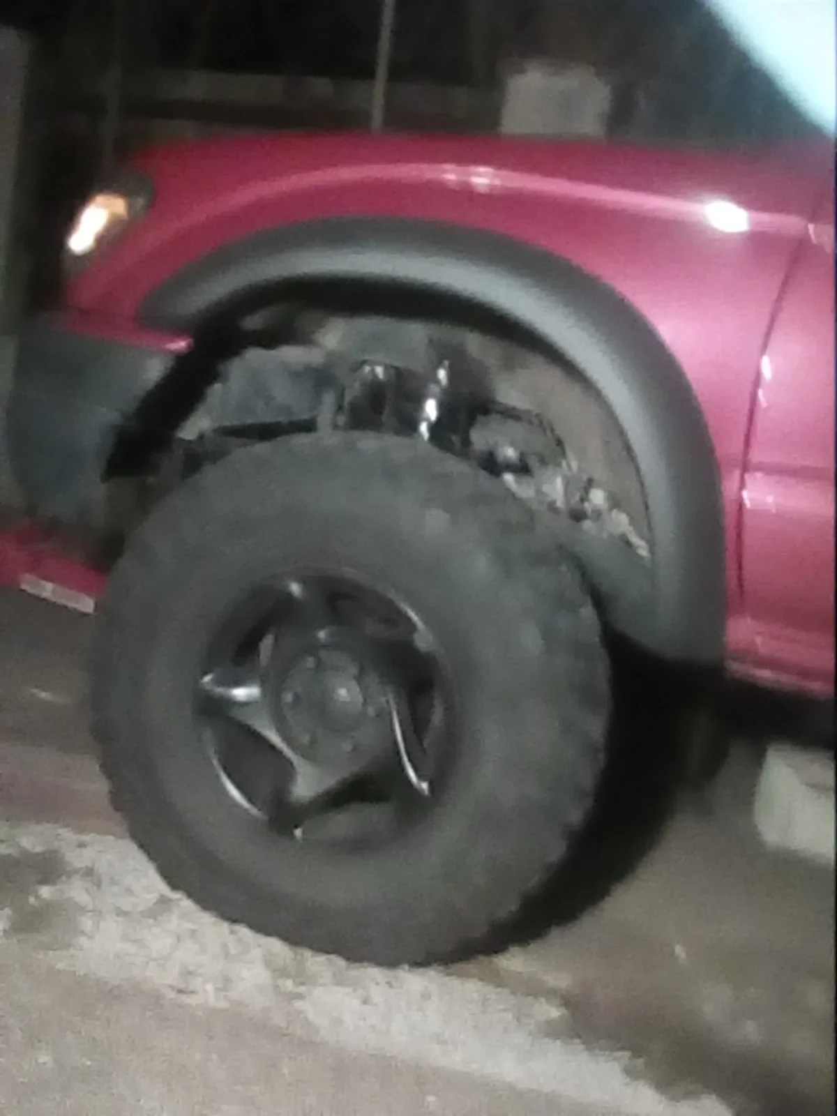

Alright, now the issue, I gained about 1.5" putting my UCA'a way out of range to even attempt getting within spec. so I'll reset the lock ring /clip down a setting & see what happens....
