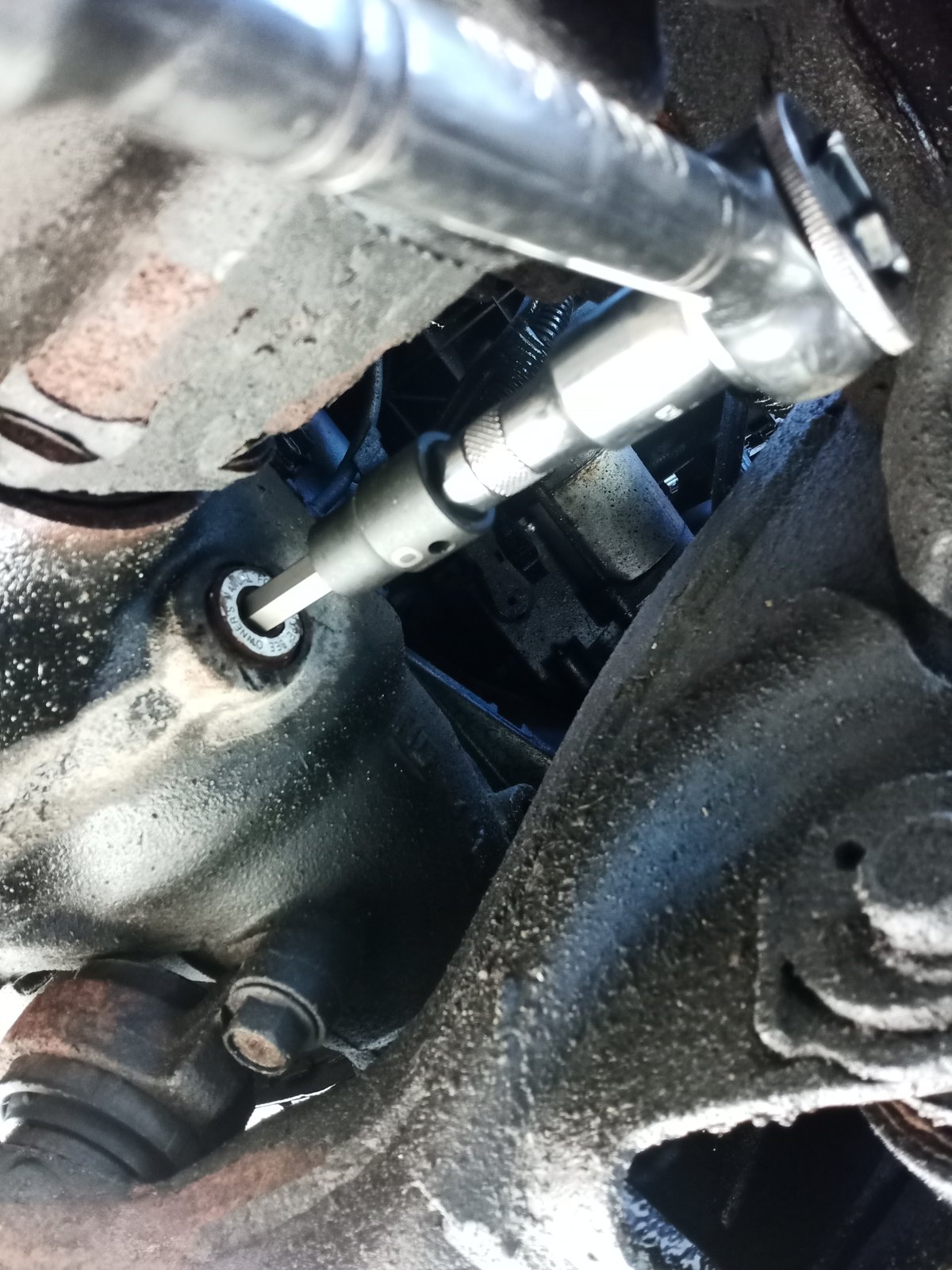

its the relative's 2nd gen i have been doing some wrenching on
finally got the front diff gear oil done for the 1st time in ever
it took a bit over 4 hours to get finished with wheel removal remount
those steely wheels are definitely much lighter than the ones on my rig for some reason
Oh ok gotcha.
its only a 3" tekTon extension!
it requried much force to remove for the first time in 13 years and needed room for a small cheater pipe on the handle since my 1/2" breaker is 24" and kept hitting the ground!
i shall now have to get a shorter breaker of better quality than that dieHard that has WAY to much slop play at the engagement
You are aware it takes more force to loosen a fastener with a deeper extension than a short to the point one, plus there's less chance of your socket, or hex bit slipping off. I've never seen the need for a 24'' breaker bar either to remove these plugs.
no, i am not exactly aware of that there
thanks for educating me
