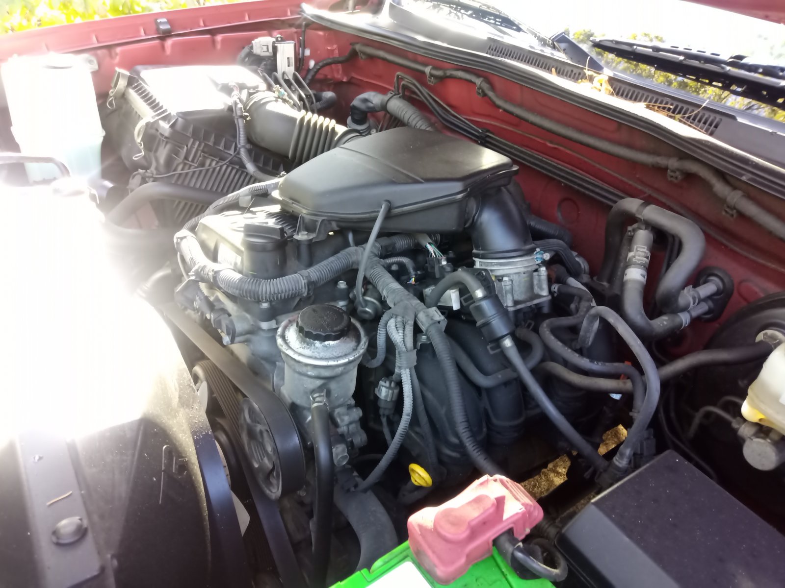

looks to me from pic 2 post back that stupid bigass fan shroud gotta be removed to replace serp belt properly, no?
