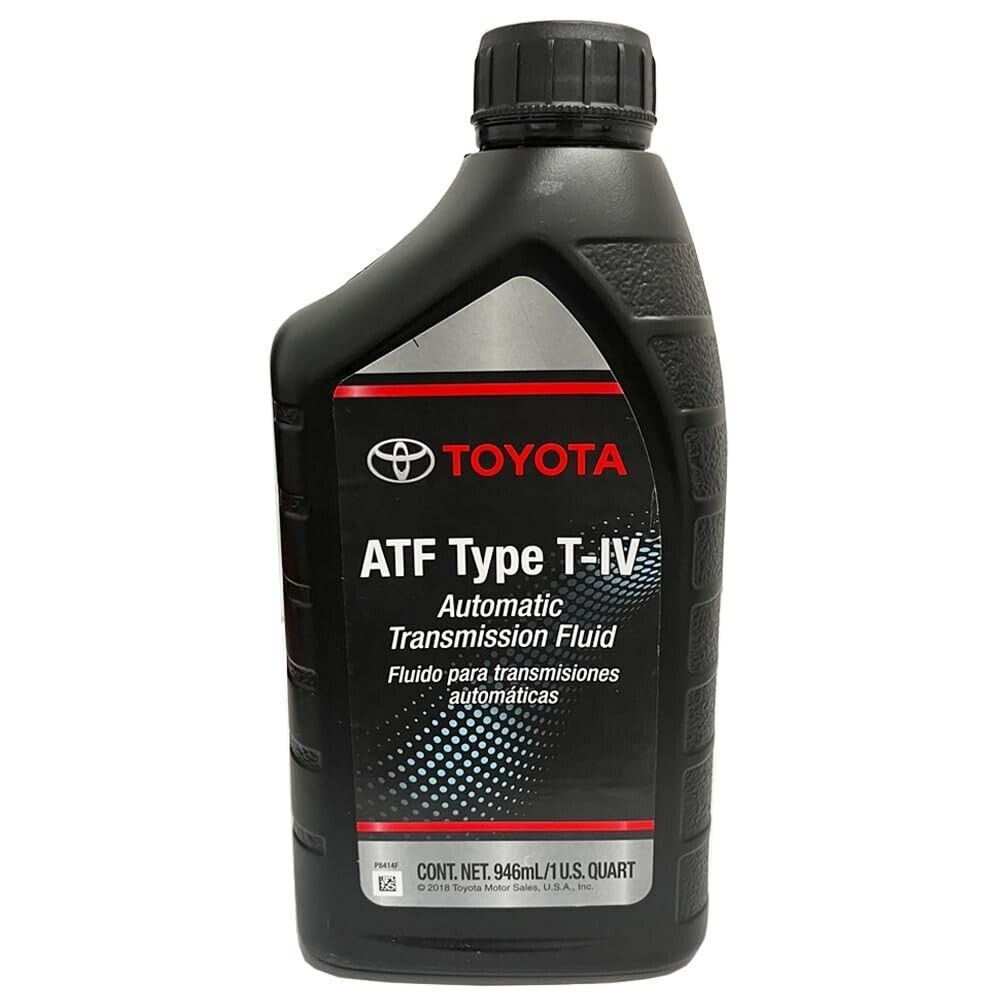

the AAP counter guy wanted to sell me some ATF for this Taco at 11$ a quart for FRAM brand
dealer OEM genuine is not much more than 5$ per quart on that discount
wtfh??
For once I agree with the toyota god...just do drain, and refills on schedule with the original toyota atf, and live is good.

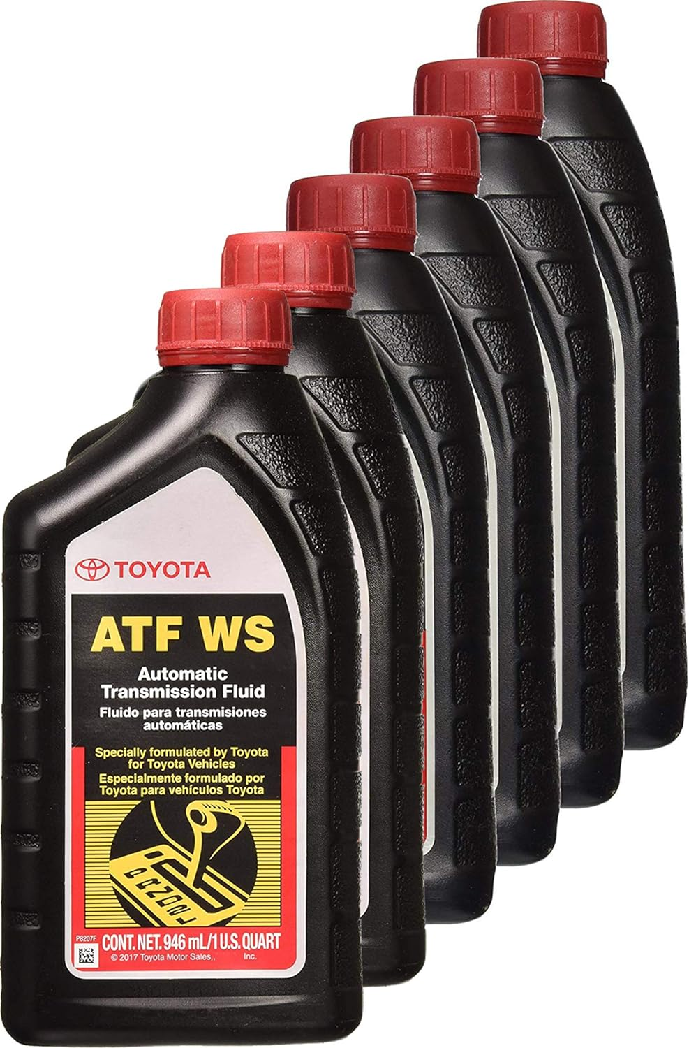

i almost bot the pricey WS stuff for this truck
WS = World Standard
glad i did some more DD on the topic
but really somebody should've alerted I to the differences
Don't rely on people on the internet to spoon feed you. If you have an owners manual, read it. The manual will tell you exactly what type atf is in that year model truck, and how much needed for a drain and refill.

It's in the owners manual to read if doing basic maintenance. You don't need to possess a high skill level long as able to read.
A drain & fill will only drain about 3-4 qts. Tacojoel is correct, so is Toyota. A completely empty trans needs about 12 quarts.
But yours isn't completely empty after a drain & fill.
Of course, you can buy 12 quarts, use 3-4 quarts, then take the unopened 8-9 quarts back for a refund.
