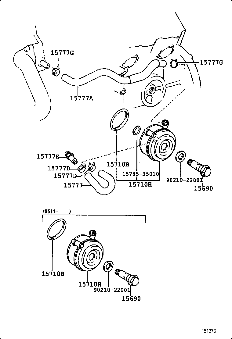

You're the guy with the visual on this hose....if it's hard and cracked, you'll need to replace it. It could be as simple as those clamps are no longer holding well enough. At one time you were able to run to the auto parts store, and cut a length of coolant hose to match. You might find better success/cheaper on eBay with the part number, or hose i.d. if needed.
That hose might have a shield on it!
Might be caked under with dried coolant like the two fatty hoses were found and weeping
The one clamp has been touched twice in 26yrs with water pump timing belt replacement

This maybe an elbow weep on the housing
It put up a struggle, plastic adhere to plastic over a quarter century
Appears either a bad clamp, a bad hose from the pump, or that white connector it goes into. Shouldn't be rocket science to figure it out.
Gotta follow the drip
I pinched the white splice and the drip moved back to the elbow
