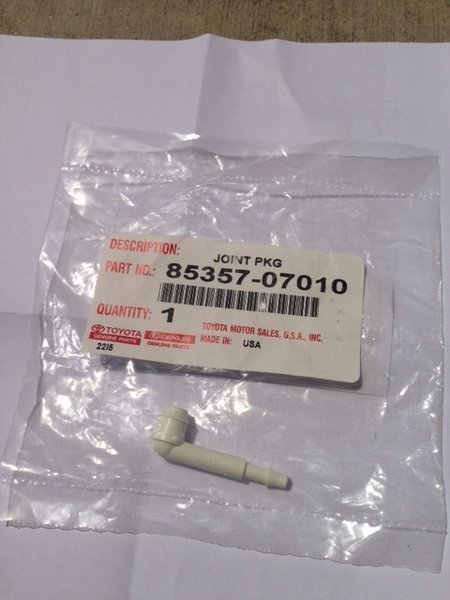

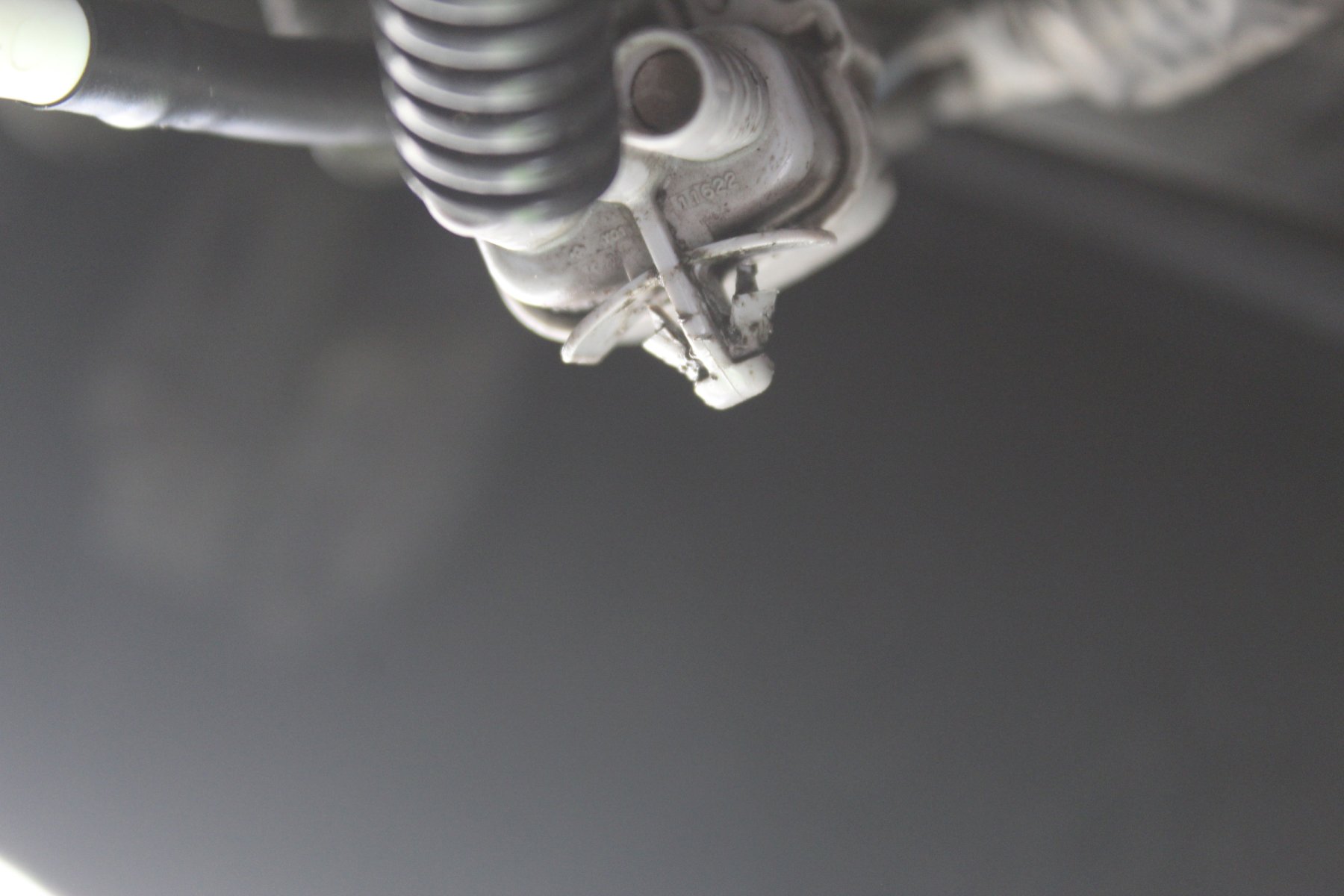

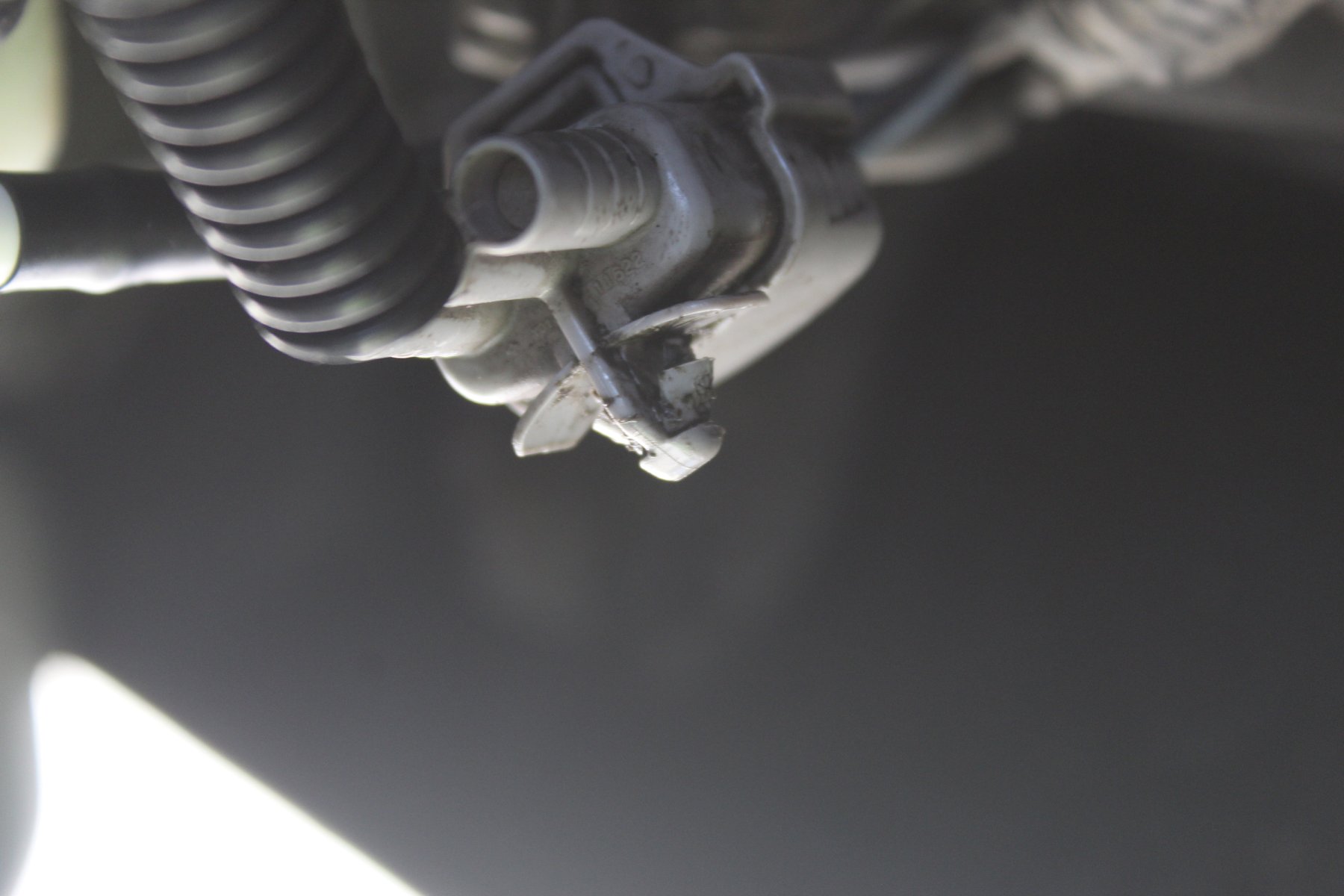

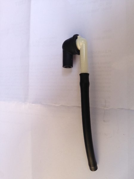

need to locate these updated parts, hoping to be in stock local
may cost 17$ :confused:

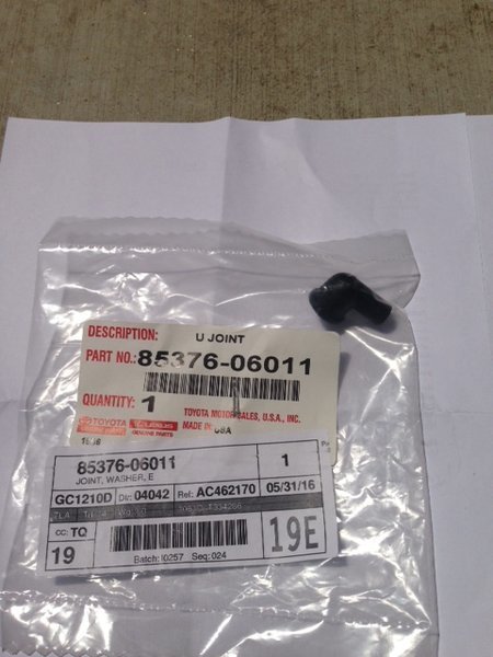

Joint Washer E - Toyota (85376-06011)​
Joint Washer C - Toyota (85357-07010)​

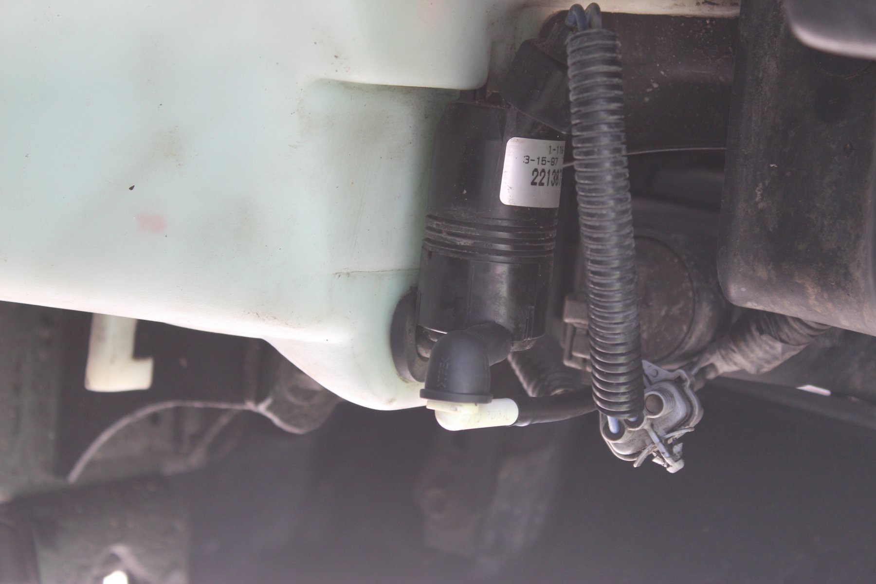

...got them new washer inline parts to stop the leak

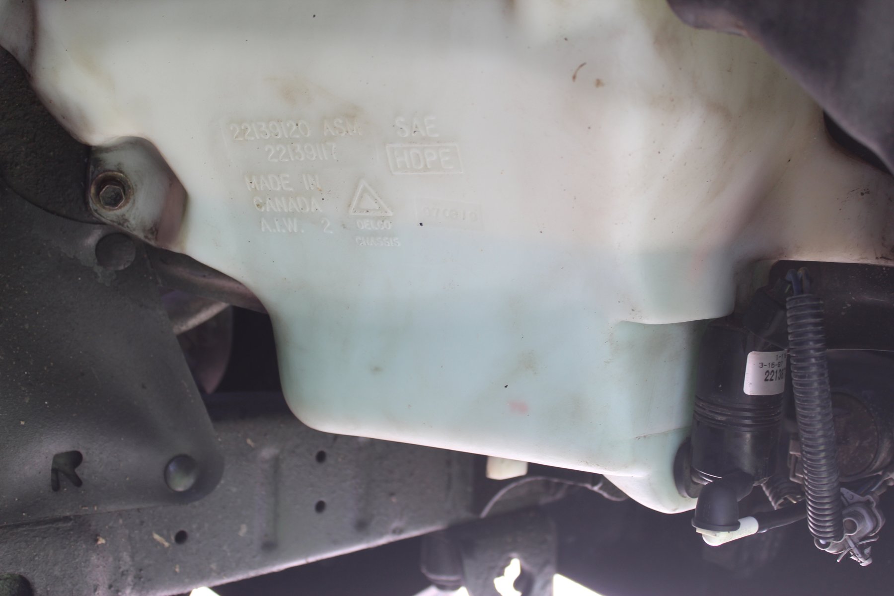

now i gotta take the stupid wheel off again to get at the packing
was hoping i could get at it without removing that wheel again!

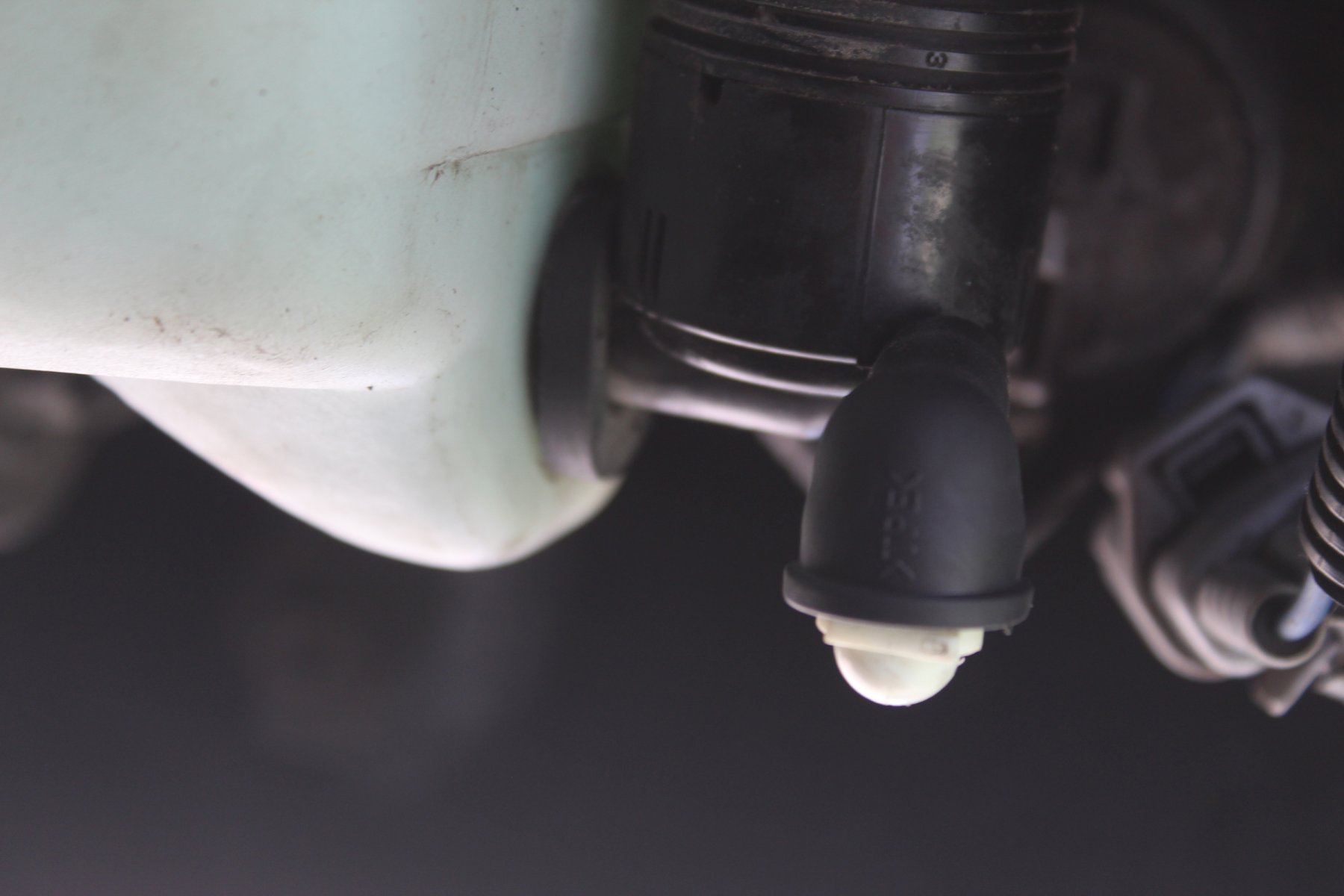

Finally got this stupid washer setup to start puking fluid onto windshield :confused:
Mighta been some air in the hose lines IDK
Made in USA parts were difficult to assemble for some odd reason
Fingers could not push rubber ujoint onto plastic tube
Careful force had to be applied with channelock pliers and some isopropyl
More force than ought to be necessary for a small plastic part such as that
Before attempting to put the packing back proper I must inspect for drips

That rubber elbow piece was quite hard rigid
No directions in the packaging either
i left this part unsecured from the packing... much dirt buildup onit
because the packing maybe need to be removed again to drill out that bolt that snapped when disassembling the packing
