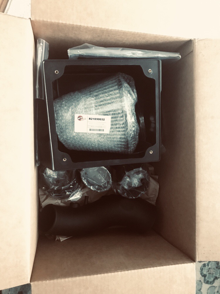

Did you get it installed right away and forget about taking out the garbage ? Like I would !lolAmazon had this for $250 it said it was suppose to shop sometime in mid March but it showed up today. View attachment 24206 View attachment 24207

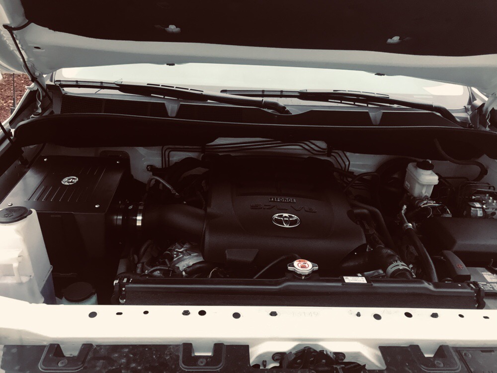

Installed aFe Power Magnum FORCE 51-81174 Toyota Tundra Performance Intake System (Dry, 3-Layer Filter) makes the 5.7L V8 with the TRD dual exhaust come alive.

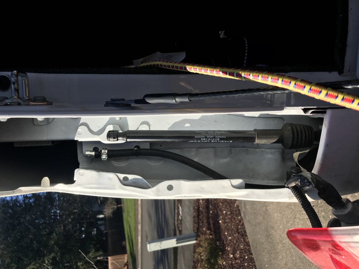

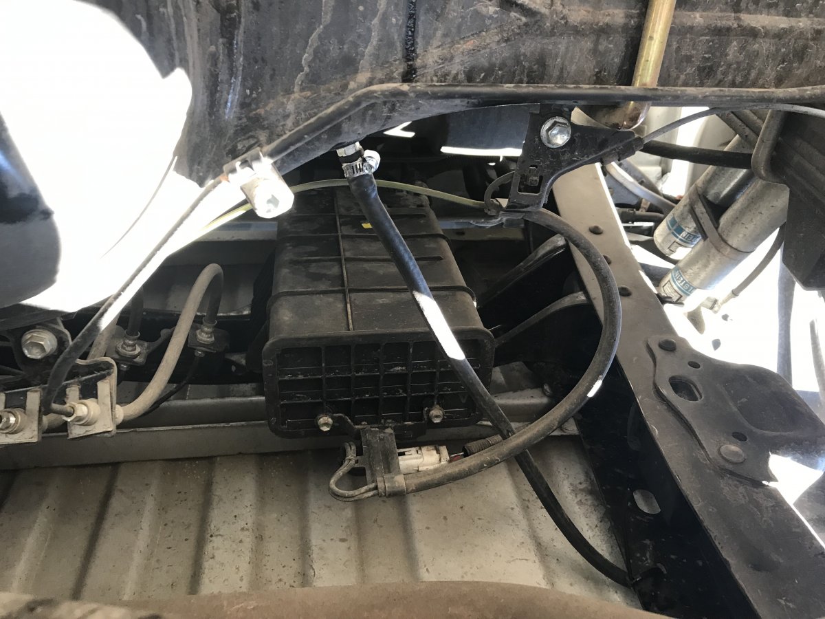

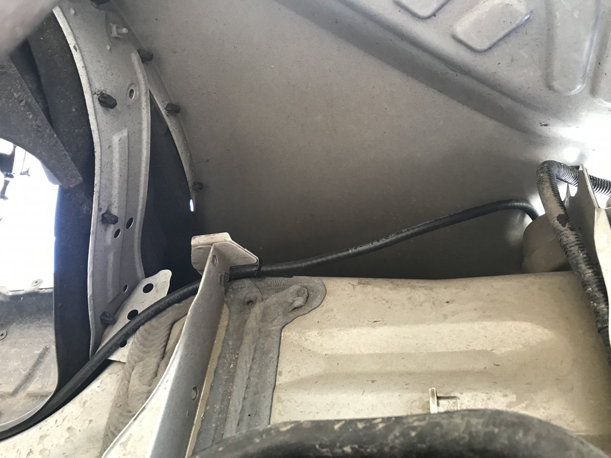

Bought a Toyota breather valve and union for the rear diff. 6’ long 1/4” fuel line hose a couple hose clamps and some zip ties. Took about 30 min to move the breather up and inside the tail light. Should be safe there. View attachment 24430 View attachment 24431 View attachment 24432

The OEM breather in its location is known to have the breather foul up from rust and dirt and stop working causing increased pressure and blowing seals.
