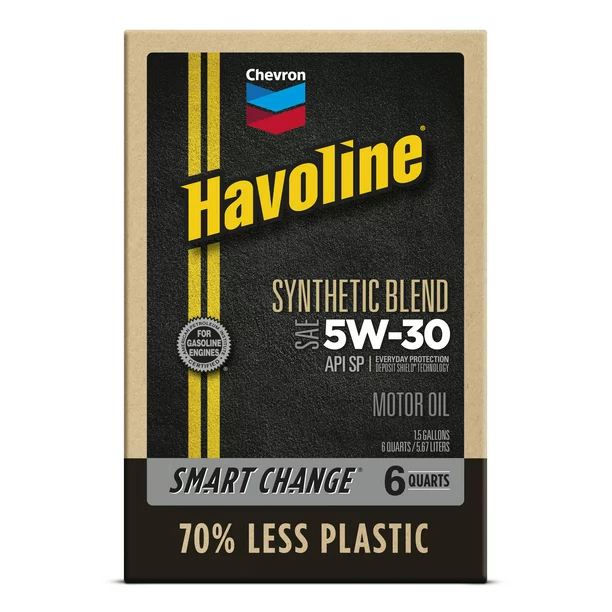

I have no idea what different toyota dealerships in various parts of the country get for motor oil, but mobil1 is really popular at many places here. Kendall was big for years at all the area auto shops, but you just don't see it at these shops anymore.
Yota shop in Topeka uses havoline by Chevron according to the return for service reminder
One is a synthetic motor oil blend, the other is a high mileage synthetic....high mileage motor oils are suppose to have have various additive packages to help prolong the life of engine seals as they become older. Seems everything is going synthetic these days with vehicles running hotter, and cleaner while having much longer oci's.
Truth is, I've never used the high mileage brands in my tundra when it got over 75k miles, and it was always fine.
It says synthetic technology and not full synthetic
So colour me confused!
Both are Same price at Walmart currently
When one is a synthetic blend, it means it's a semi synthetic which is fine. Usually synthetic means it's a full synthetic, but much of that is a marketing ploy. It's usually found to be a semi-synthetic. Even mobil1 is a semi synthetic, yet they advertise their product as a synthetic. Amsoil is a full synthetic motor oil. You really need to carefully read if these oils say in writing they are a full synthetic.
