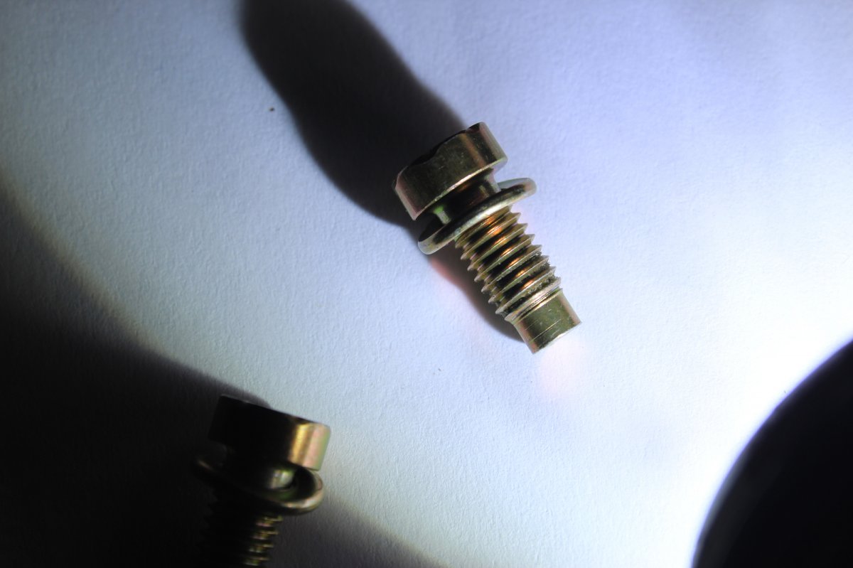

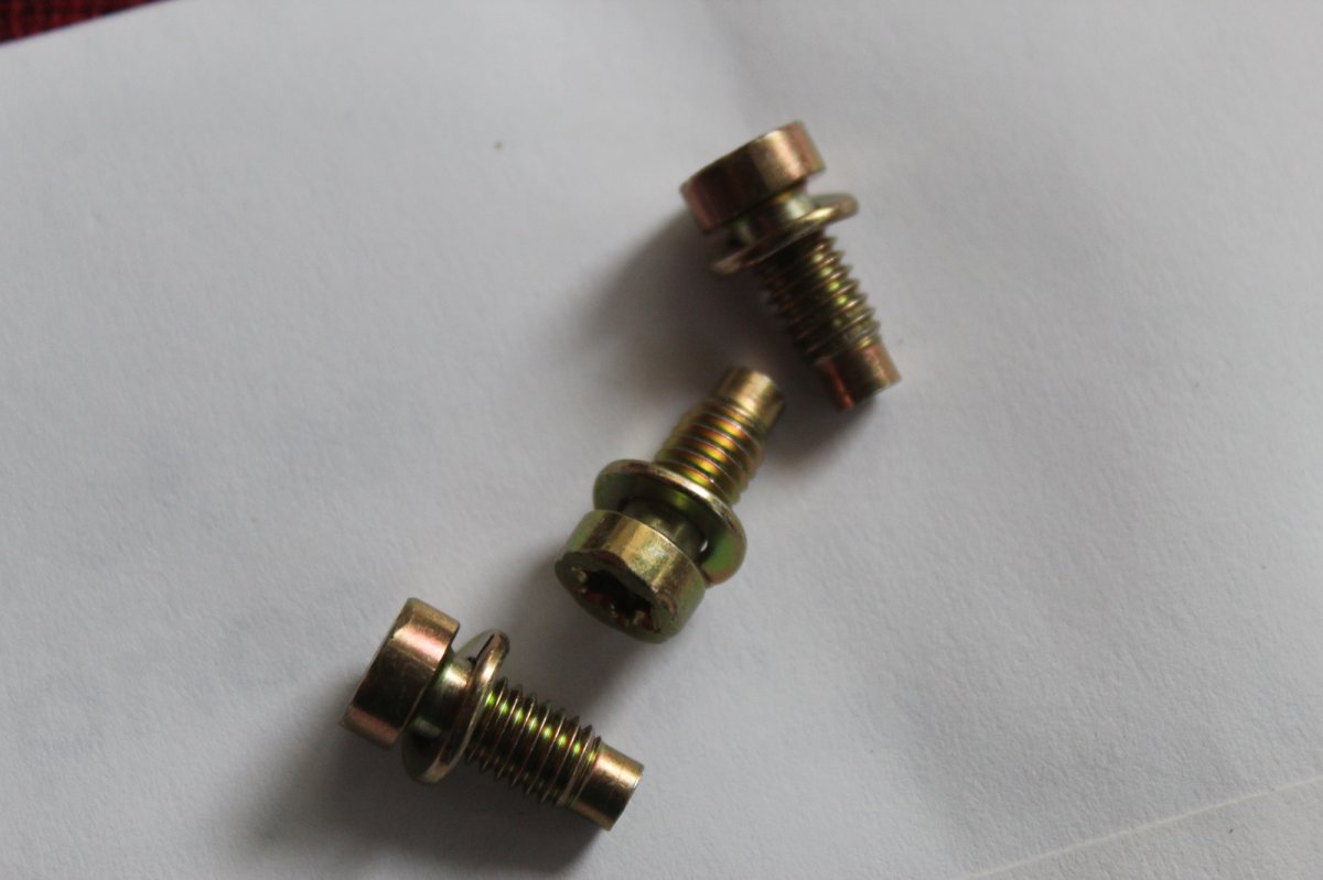

Maybe drill them out?
High torqued from the yota factory
One of the 3 already started stripping :confused:
Its why you should of immediately put the heat to them and used a torx and ratchet on them. Sometimes it helps hitting them with a hammer after soaking them for awhile with pb blaster. Drilling is always my last resort.
Forgot to add if your handy with a welder, you could weld another bolt to those stripped heads, and try to break them loose.
its also very possible they have sorme sort of thread locker on them from factory install.
the new OEM torx bolts bot from Toyota have some reddish stuff on the threads upon inspecting last evening
i was warned somewhere about heating a knuckle and doing damage
there is extremely limited clearance around the hub on that knuckle, the shaft of the tool i was using was rubbing on the edge of that hub!! no clue how you could get a real ratchet extension to hit that spot head on
so far i think we are up to nearly 10 bolts that have had to be drilled out of this car because the head busted off :mad:

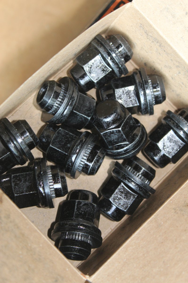

I would think it eventually would. I never had any issues with the chrome lug nuts on my tundra. So far even these black chrome like lug nuts on my 2020 tacoma have held up fine. I would think eventually their going to have issues.
the OEM black lugs in the front have weathered 25+ years
i bot some new DorMan lugs since the Toyota lugs are close to 8$ each... thats a lot of coin!
DorMan were about 2$ each iirc
but the coating on these DorMan look very thin at best

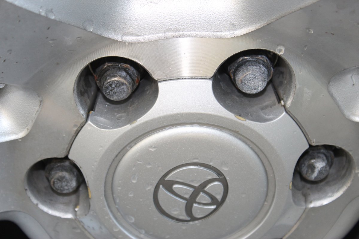

this is what the front lugs looked like as of a year ago
another year of weathering on them...
