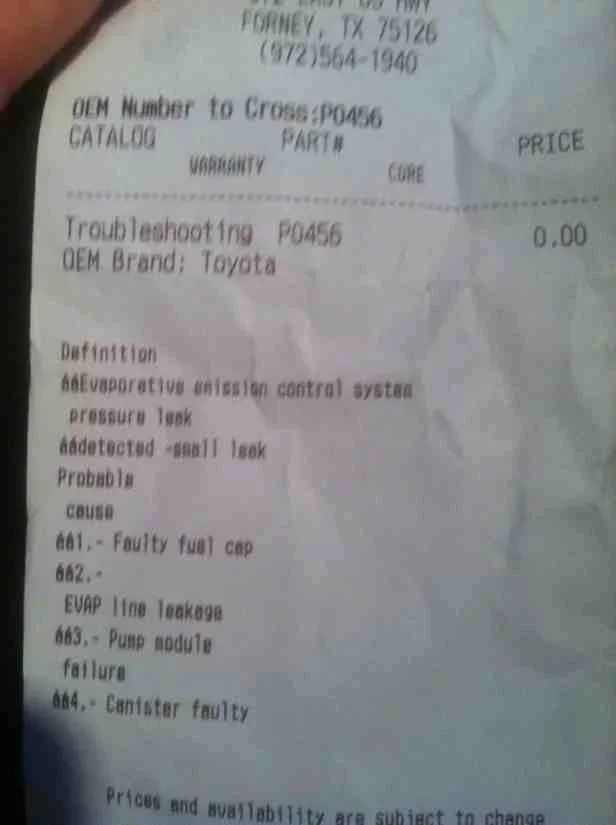

On Saturday I had my front end in my garage cause I was cleaning the interior and when I was finished I started backing up into my spot and all of a sudden my engine shuts off, so I had to put it back in park and turn the key to the off position to restart the truck. Yesterday as I was driving home from school my check engine light came on, so I took it to autozone today to get it scanned and this is what came up. ImageUploadedByTaco Forum1392943980.056352.webp
Did you check your fuel cap? I know it sounds ridiculous. Just make sure it's on right. Go to a auto place and do a fuel line pressure test
I made sure that was the first thing I checked before going on to the major items. I just had the time to research this code and I might just need a new cap from what it looks like cause the seal is possibly warn out and it could be letting air into the system.
