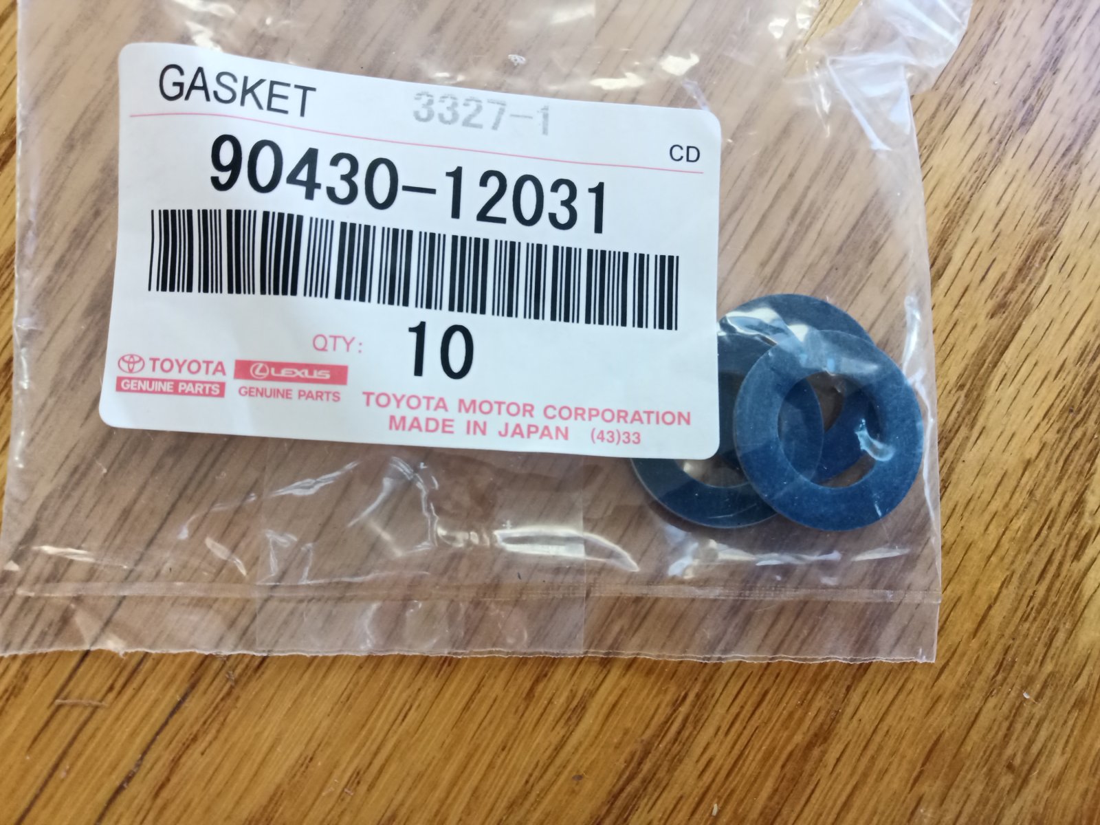

how much are the OEM ones?
that will rust most likely
AAP currently has good speedPerks deals for the next couple of weeks
Depends, some dealers don't. Most oil change places don't either.
When I had toyota care for my first 2 oil changes, they never replaced that original grey washer with a blue one...I haven't had to either.
