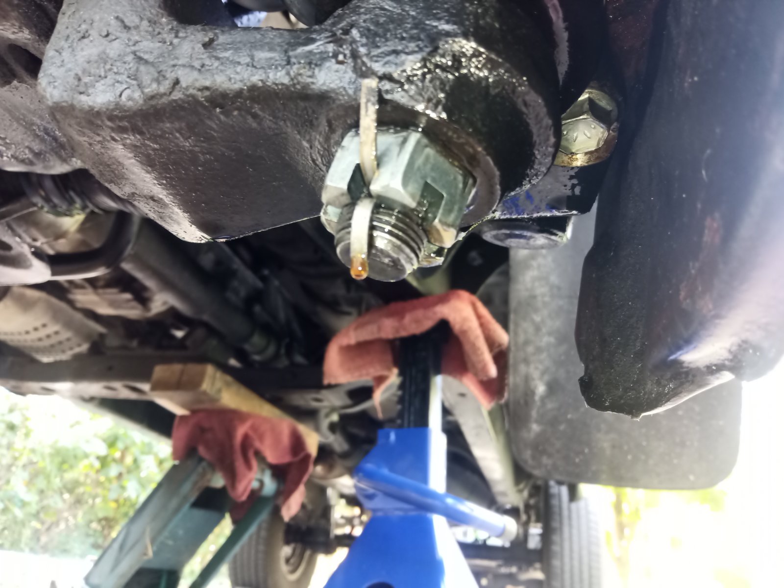

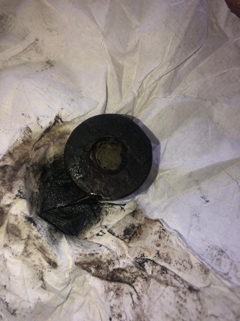

Found some sketchy black oily drip by the new axle
Not quite sure where it come from or if it's undercoating spray
Could it be when the axle shoved into front diff the seal was bugged up![]()

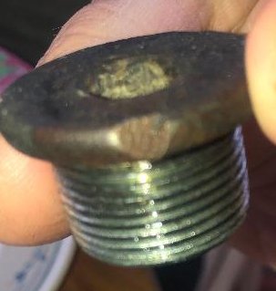

If you do the front diff on your own. Allow me to offer a tip.So I betcha perhaps the seals got roached
Down day tomorrow pending raon raim rain
I will attempt to get at front diff check fill, it's in a challenging spot
Then do drain fill if I can reach it and hex plugs not over torque d
Could be black engine oil mixture but I could not see any weep directly abouve the area
It's all over the newish napa boots on spots
Make sure you use the correct size hex socket when removing that front differential plug...and use a 1/2 ratchet tool, or breaker bar for it. They can be in there pretty snug...you don't want to strip the plug.

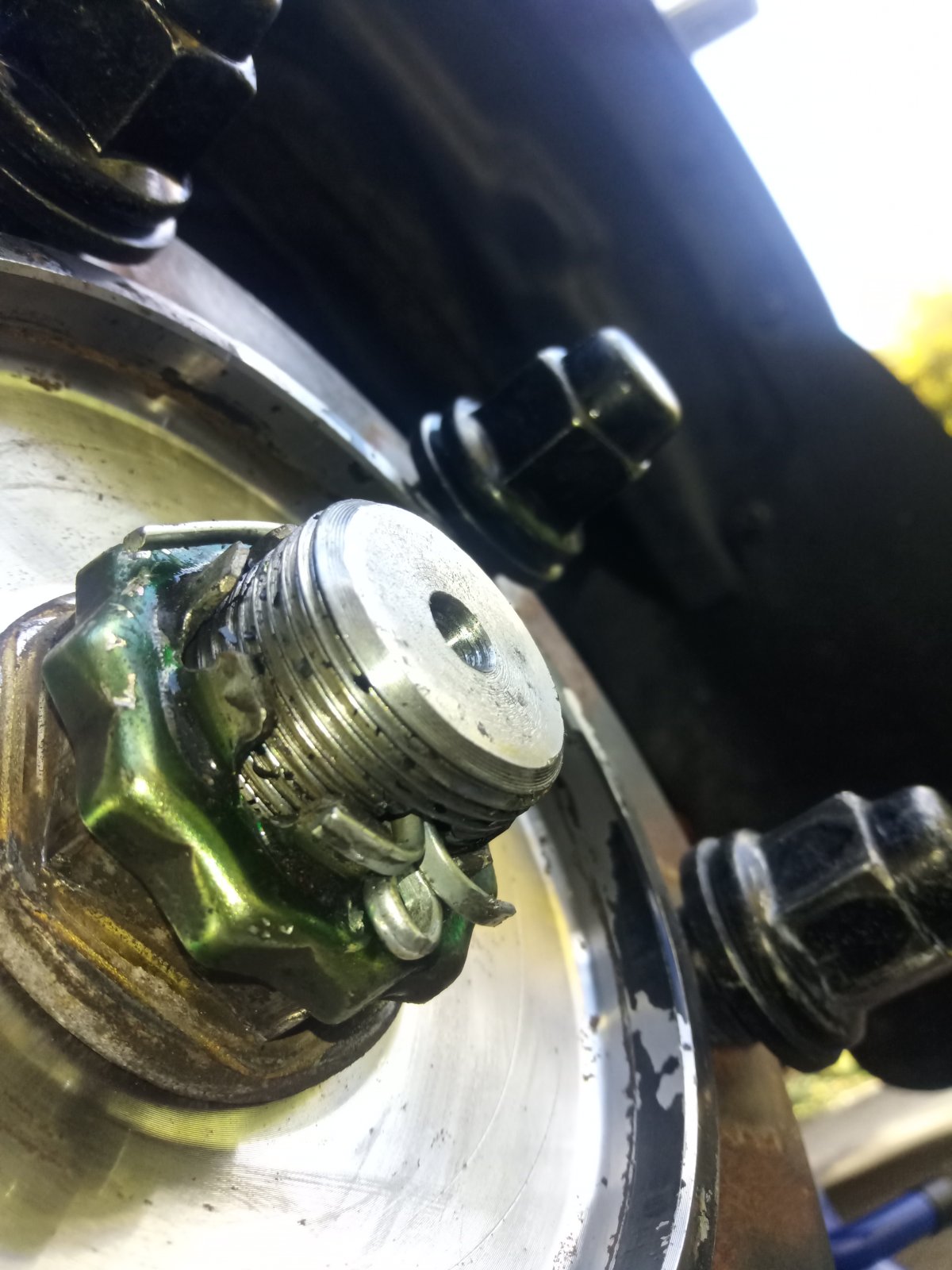

Was just going to say it appears someone used whatever they had, and jammed a double cotter pin in there. Very ingenie-ass.wotn tarnation is this
i do not know whut to think here
ordered the correct cotter key pin (one for the other side as well) from the dealer PLUS 1 axle grease nut to see what is what
because this axle grease nut does not look original and not tall enough, but the originals were discarded into the dump
this is the driver side of which I have had 3 roasted wheel bearings and now finally have a new hub on there
